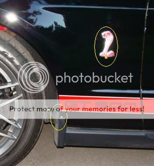

I popped in to a few shops in the area and enquired about the inspection points that the tech would be paying particular attention to when the Shelby rolls into the service bay. The same areas all of you have pointed out were almost exactly the same. One of the shops in particular seemed to be a bit more "friendly" and as such will be receiving my business. This gentleman even recommended ringing Teslayn Engineering to discuss the possibilities for bringing the car into conformity and gave a few options for what would "pass" his inspection for the side indicators.
Teslayn claims to have "successfully developed a system for the 2010 up S197 Mustang which allows full functionality of the Federal specification sequential rear tail light turn signals."
For the side indicators, I am going to attempt to mount these either directly below the snake side emblems if the snakes utilize a mounting hole or directly above the rocker panel...see below. I am unsure of the minimum height that the indicator needs to be mounted at.

It's all on my Corvette page above:
SVA requirements are as follows: within 2600mm of the front of the car, maximum height 1500mm, minimum 350mm with angle of visibility between 5 and 60 degrees inclusive when viewed from the REAR

Postby Expat » Tue May 24, 2011 7:15 pm
Right. I just don't know how high the upper portion of the rocker is from the ground. The car is not here yet, so I cannot measure to see if it is above the 350mm minimum.
A lot of good info on your write-up.

Postby LV51FER » Tue May 24, 2011 7:27 pm
300mm is 12" so i would say it's too low. many put them in or under the mirror. Some even drill the badge to fit an LED. It would be cool if you could make the snake eyes light up....
